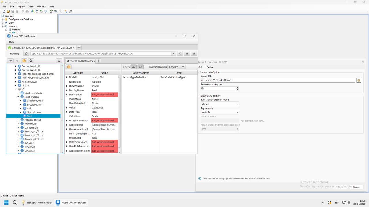

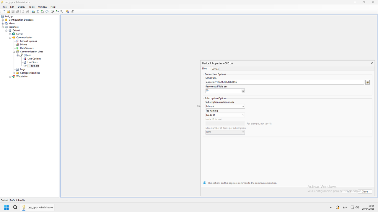

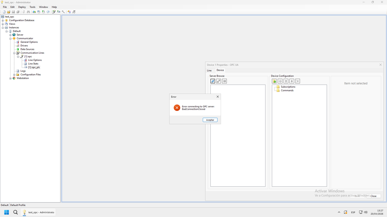

quintelosky
Participanthttps://i.postimg.cc/4xpKY7Db/test-opc-1.png
https://i.postimg.cc/nLZXBVx7/test-opc-2.png
https://i.postimg.cc/zGTLybsv/test-opc-3.pngError connecting to opc server: BadConnectionClosed
