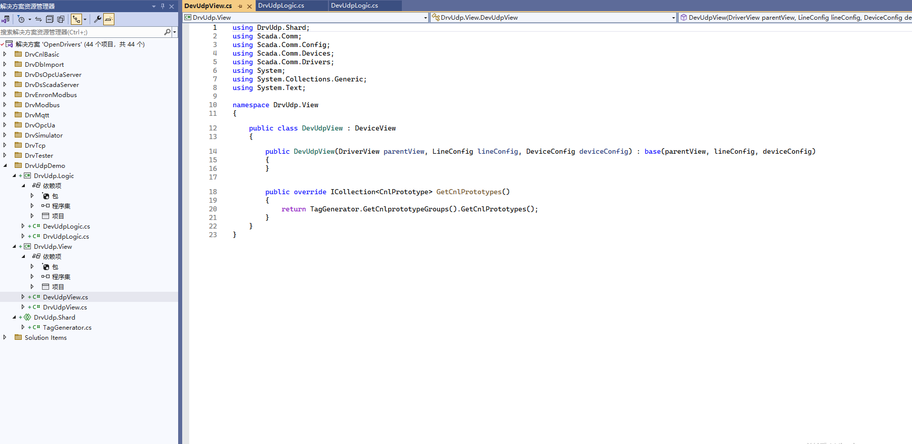

    I want to try writing a driver module. After successfully generating it, I placed the .dll files in their respective locations. However, I am unable to use them in the admin. Below are screenshots of my code and my attempt to use it in the admin.
    DevUdpLogic
    DrvUdpLogic
    DevUdpView
    DevUdpView
    TagGenerator
    MainOption
    Device polling open properties
    #13703
    Mikhail
    Moderator
    Full class name of DrvUdpView must be as written in the error message. You should change the namespace to meet the requirements.
