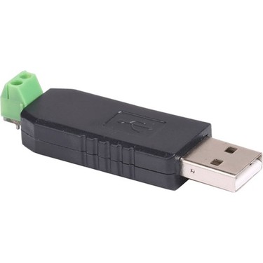

    I am using Windows 10 Pro on my computer. For the physical interface, I am using a classic USB-RS485 converter.
    rs485-usb converter
