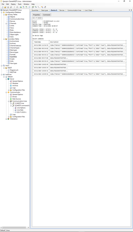

    Device command history
    the commands sent from the button are the ones without the “Code” value

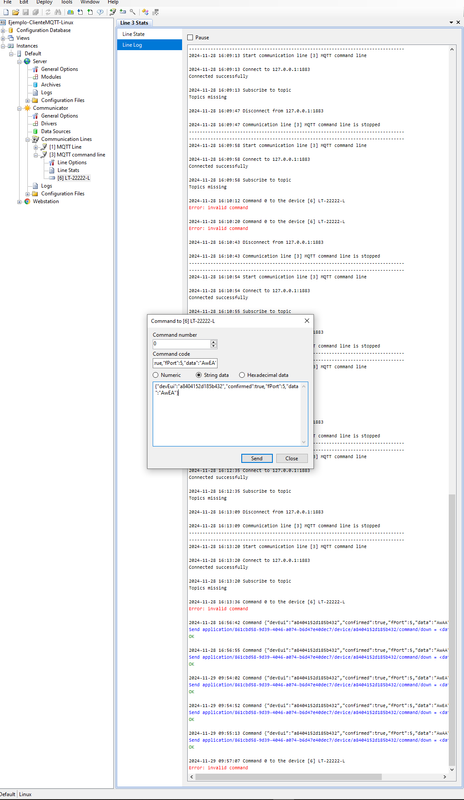

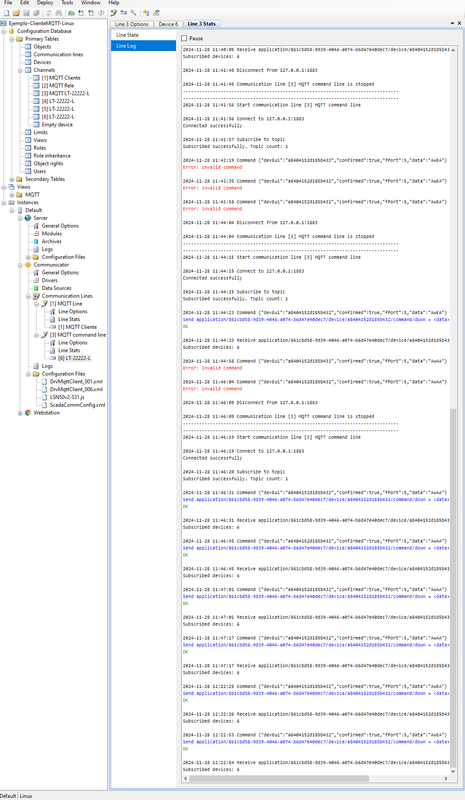

    Also, the log line shows the error when the command is sent from the button and OK when it is sent from the administrator.
    log line

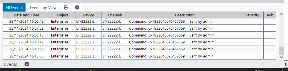

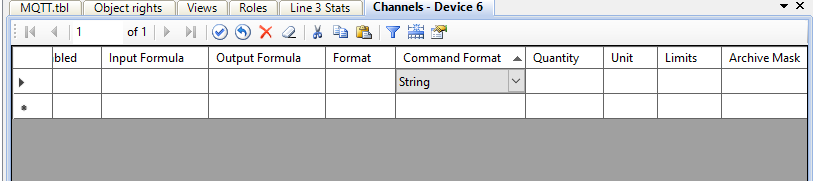

    On the same line of questions, I want to send the JSON payload through a button, but I can’t get the format. In the channel device configuration, I select String as the Command format, but the output of pressing the button is in hex, and with this method, I get an error: invalid command.
    command format
    the payload is this:
    {“devEui”:”a8404152d185b432″,”confirmed”:true,”fPort”:5,”data”:”AwAA”}
    the output of pressing the button is this:
    button output
    output line log:
    output line

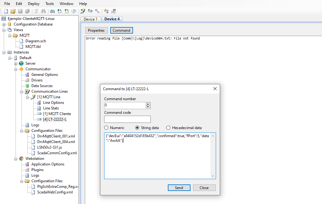

    Hi, I managed to send commands, I created a communication line for each topic, and then in the communication line for sending commands, I made an MQTT client device, added a subscription to the topic I wanted to send commands then added 2 commands to switch a relay, while adding the commands, in the command code a had to put the actual command I want to send and if not, does not work, and finally to send the command, right click on the devices, select “Send Command…” put the command I want to send in the command code and the string data.
    command output

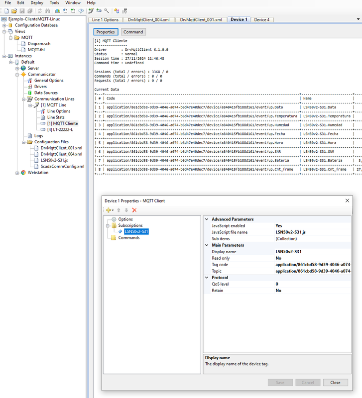

    this is the Device 1 properties (works fine, I receive data):
    Device 1 properties

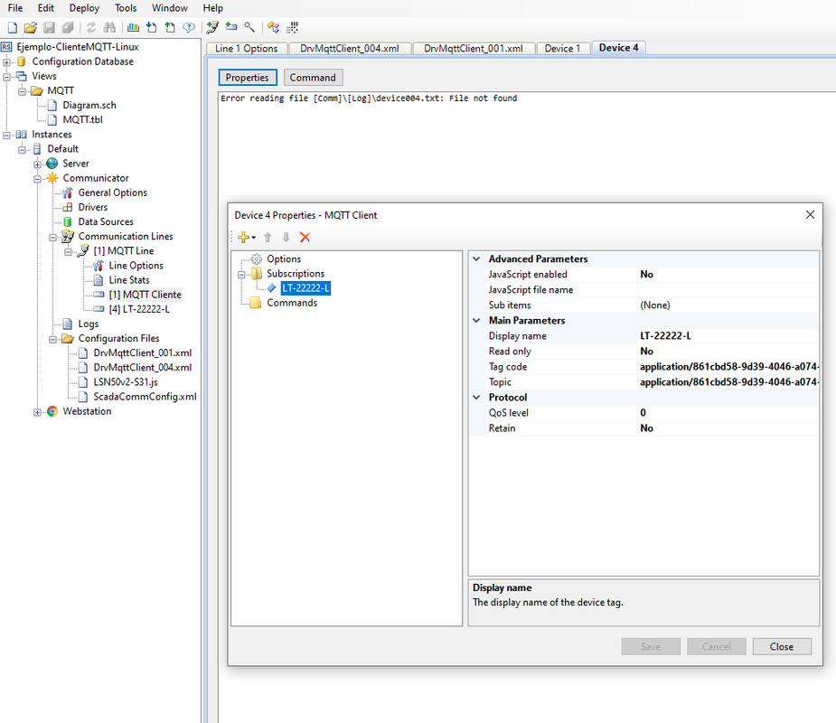

    this is the Device 2 properties (not working, can’t send commands)
    Device 2 Properties

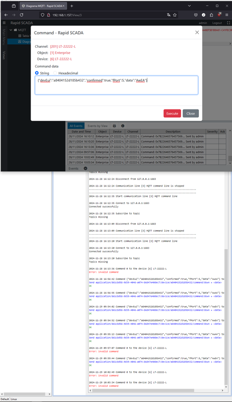

    this is how I send the command:
    command

    I created another device for sending commands because I am working with 2 different devices(one to subscribe (works) and the other one to send commands (doesn’t work)). Also, this is deployed on a Linux machine, while the administrator runs on Windows.

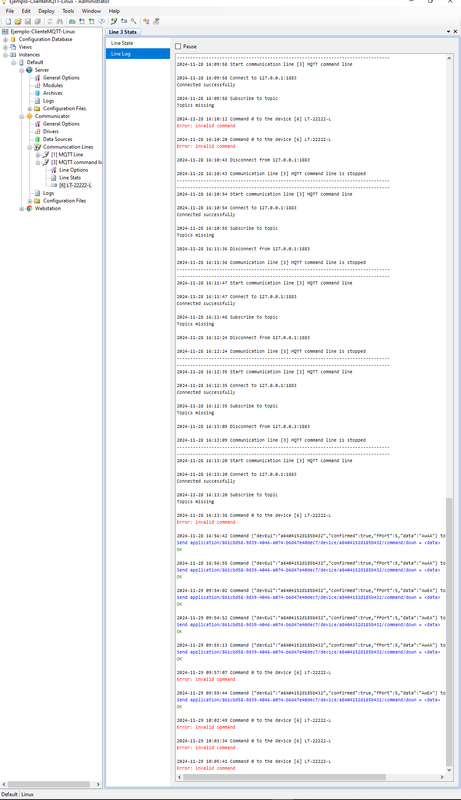

    For the new device, I added a subscription with the topic where I want to send commands then I right-clicked the devices, selected “send command…” and typed the command in the command code, the command I need to send is JSON formatted
    {"devEui":"a8404152d185b432","confirmed":true,"fPort":5,"data":"AwAA"}

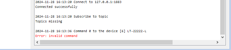

    In the Line Log when I send a command, it says:
    2024-11-26 10:47:17 Command '{"devEui":"a8404152d185b432","confirmed":true,"fPort":5,"data":"AwAA"}' to the device [3] MQTT LT-22222-L
    Error: invalid command
