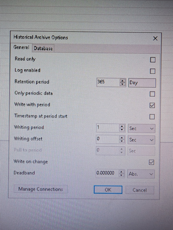

    TroyV23
    Settings
    These are the archive settings I chose, but unfortunately it’s still creating periodic logs every second which is too much data.
    If I remove the “write with period” setting. How often will the device be checked for changes?
    Also, side question. Is there a quicker way of editting multiple channels because I find myself having to edit hundreds of lines manually with every change I do. I can select multiple rows but it doesn’t let me edit them simultaneously.
    Thanks!
    #17464
    If you untick “Write with period”, the archive will write data only when it changes.
