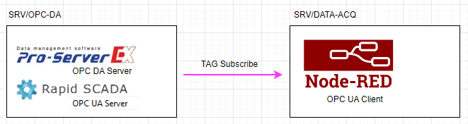

    Thanks to that I’m able to communicate with remote server with opc da, like on diagram. Rapidscada rocks – it was very easy to configure! 🙂

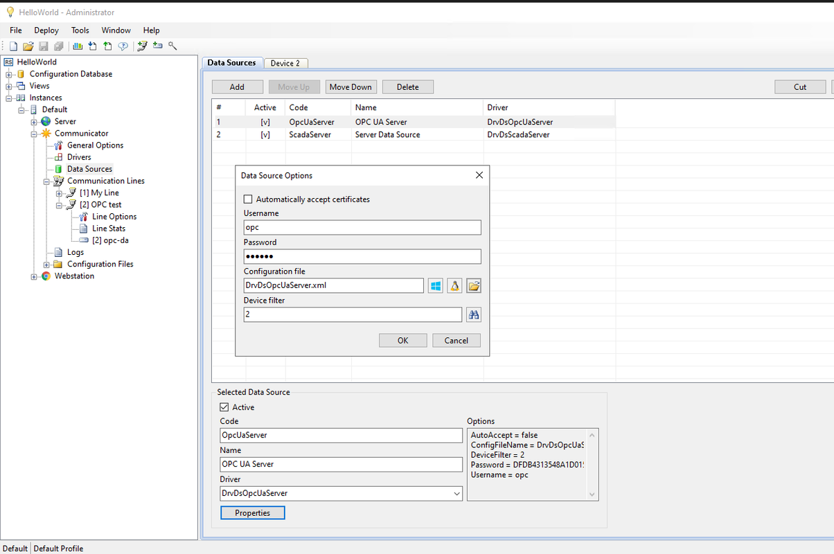

    Mikhail I have question how I can configure SecurityPolicies on the RapidScada OPC UA Server. In OpcUaServer properties I can see only this options:
    opts
    But dont know what Configuration File is meaning, because in path “SCADA\ScadaComm\Config\DrvDsOpcUaServer.xml” there is default configuration xml?

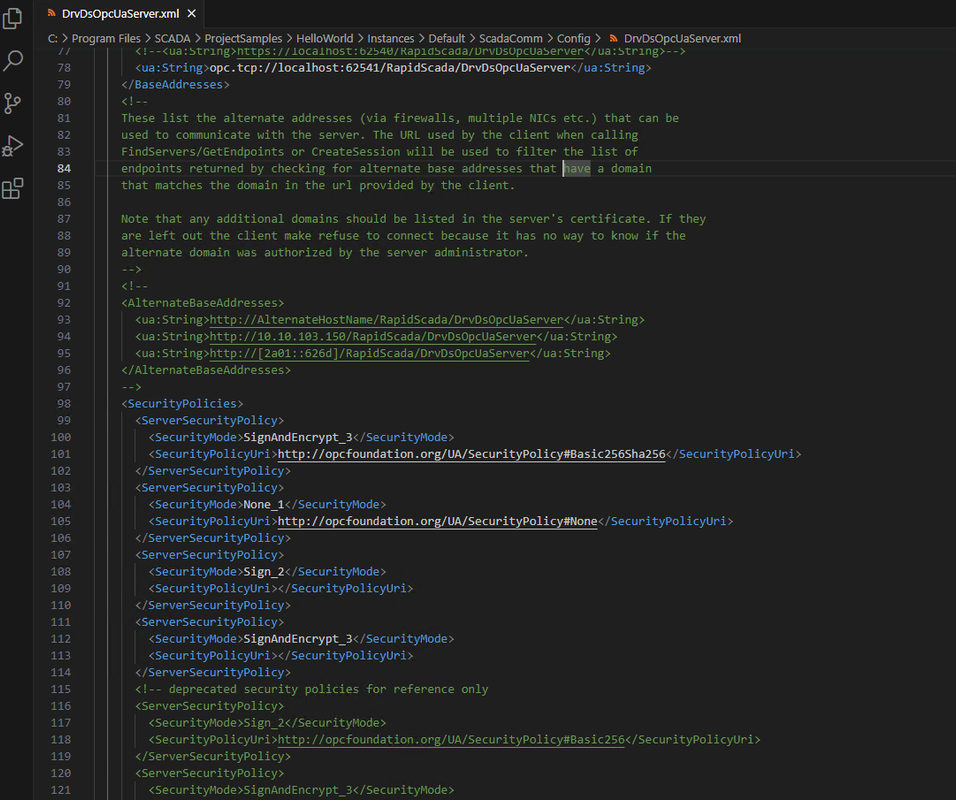

    In this file I see some <SecurityPolicies> options, how to configure and then use it?
    config
    #13261
    If DrvDsOpcUaServer.xml does not exist, the driver creates a default configuration file. You can put it in the project and change if needed. I recommend to use the default configuration if it fit your needs, because there are a lot of settings which are not obvious. The file in the screenshot was created by the OPC Foundation developers (and included in the driver), and I haven’t seen any documentation related to it.

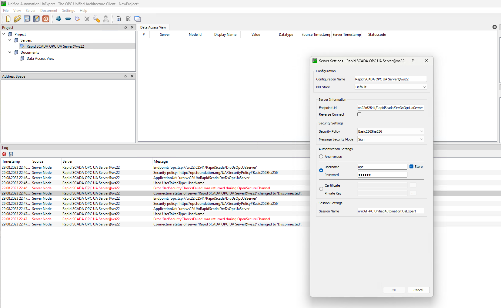

    Yes, I have got errors, below screens from my tests:
    1. If i choose Security Policy: “Basic256Sha256”:
    256

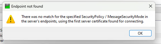

    2. But if I choose Security Policy: “Basic256”, then I have:
    unsu
    and if I close this popup by click on Ignore button, next one showed:
    notf
    Looks like RapidScada on default settings somegow supports Security Policy: “Basic256Sha256” but client cannot authorize.
