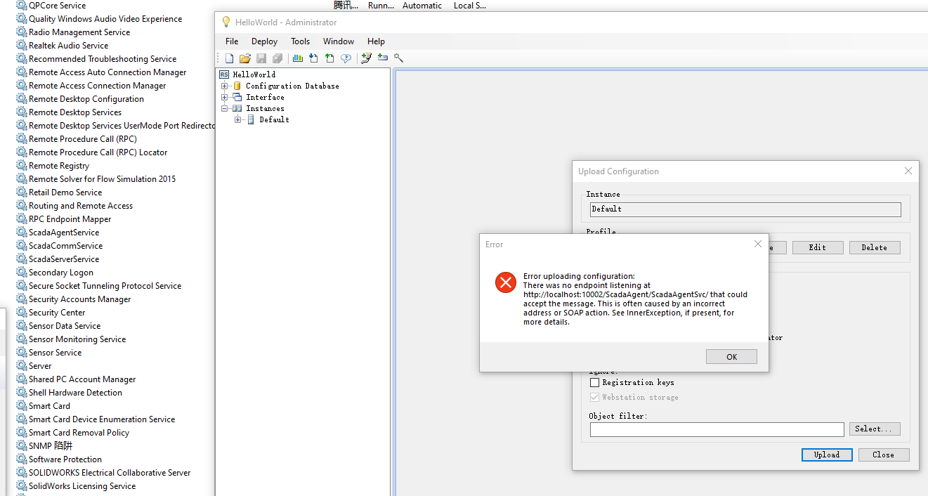

ParticipantI make the directory “Temp” manually in the bin directory.
run ScadaAdmin again.
The upload button can go on.
But It fails at last, and shows:
http://www.suzhoulily.com/pdf/Screenshot%202021-08-02%20094517.pngNote:
the scadaagentsvc is running with released built version.
the ScadaAdmin is also running with a released built version.lilytech
ParticipantDebug shows, it get a unexist file name:
private bool UploadConfig(DeploymentProfile profile)
string configFileName = GetTempFileName();The name is:
configFileName = “D:\\Works\\SCADA\\scada-5.8.3\\ScadaAdmin\\ScadaAdmin5\\ScadaAdmin\\bin\\Debug\\Temp\\upload-config_2021-07-30_11-09-36.zip”AT the directory, there is no such file.
lilytech
ParticipantWhen up load the configuration, show:
Error uploading configuation:
Error exporting configuration to archive.lilytech
ParticipantScadaAdmin.exe menu issue: solved.
Built AcadaAdmin5But when start AcadaAdmin5’s AcadaAdmin.exe, file open the hello project, I am not able to upload the configuration?

C:\SCADA\ScadaAgent>
lilytech
ParticipantAfter the up action excuted, Login still shows: “Server is unavalilable”
