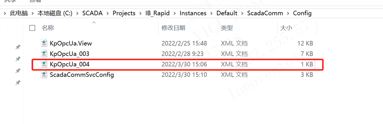

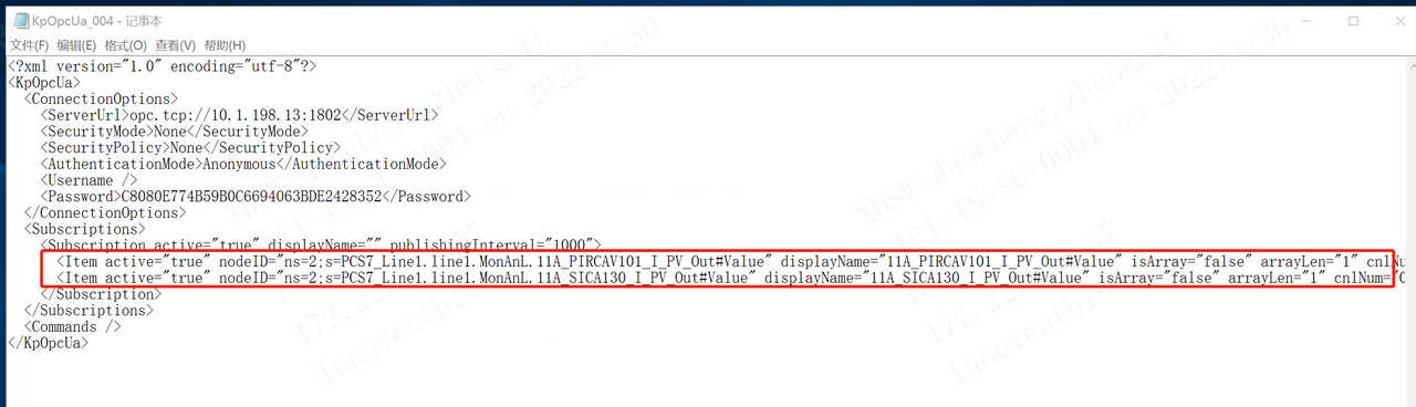

    I have a test project. Which with many OPC tags need to be collected. OPC tags have the same naming rules. How can we use tools such as Excel to import OPC channels quickly? I tried to modify KpOpcUa XML file under the project folder, but it didn’t seem to work
    TKS!
    Best Regards!
    File location
    Xml

    Hi,
    I think, you are on the right way.
    You can copy KpOpcUa*.xml and then edit it with XML editor like Notepad++.
    To find what lines should be edited, create 2 files manually, then compare them using WinMerge free app.
