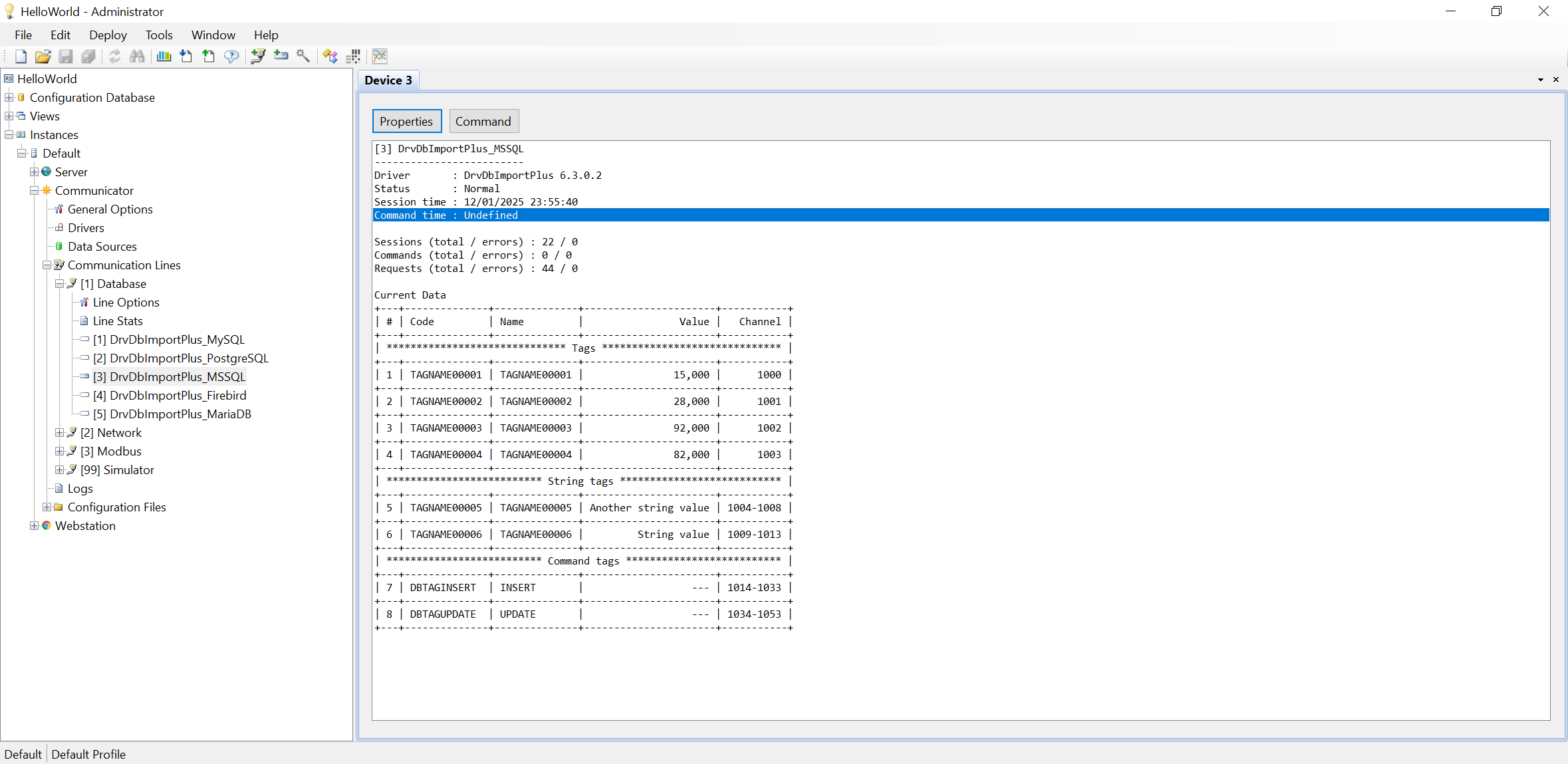

    #16828
    JurasskPark
    #16829

    @JurasskPark
    I will take a look at this module.

    Currently long strings are not supported by the DrvDbImport drvier. I hope, we will implement it in the future.
    If the strings have fixed values, they can be presented as numbers, and enumerations can be used.
    Alternatively, use the community driver noticed above.
