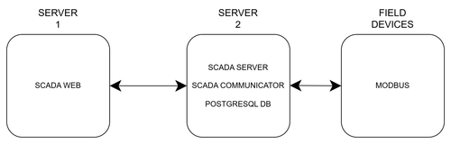

    Hello,
    What is the architecture of your solution?
    #18036
    TroyV23
    This is how it is set up right now:
    Diagram
    Running Windows Server 2019 (x64) on Web server, and 2022 (x64) on the Application Server.

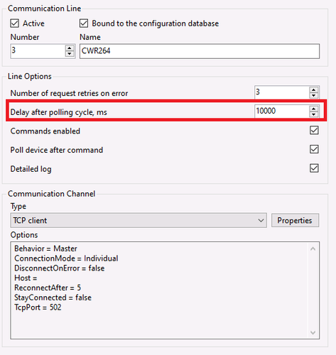

    TroyV23
    Is this possibly an issue?
    https://iili.io/CCFzeCg.md.png
    • This reply was modified 3 months, 3 weeks ago by Mikhail.
    #18040
    The architecture is OK.

    TroyV23
    [img]https://i.imghippo.com/files/U9965lM.png[/img]
    Is this ok?
    • This reply was modified 3 months, 3 weeks ago by TroyV23.
    #18048
    TroyV23
    setting
    #18055
    The highlighted value is too big. Use a value from 0 to 1000.
