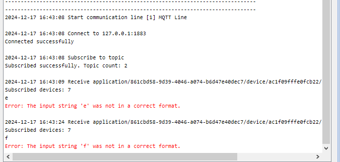

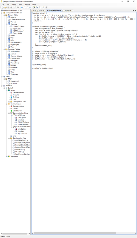

    #15820
    Jorge
    Hi, I have a similar question. I am receiving data via MQTT and getting an 8-bit binary that I want to convert to an ASCII character. I am doing the conversion in the JS file, but when I try to put the character in a view table, I get an error.
    Communication line error:
    line error
    js file:
    js file
    #15821
